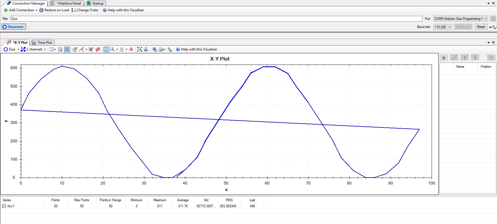

Hi there,
I was wondering if it is possible to use the time plot as an oscilloscope by adjusting the speed of the time axis. I am measuring oscillations with a fixed frequency and it would be very helpful if I could some how fix the sine waves in place in the time plot, so that I can see if the phase shift of the data from my two sensors.
Would be great if someone could at least tell me if should keep trying realising this in Megunolink or that I should just give up and buy an oscilloscope :)
Cheers, Tjeerd

Sun Mar 07, 2021 11:34 am
Hi There!
I found a way to make it work :D
Instead of using a time plot , I used a XY plot, as suggested by Phil in reply to another question I had. The time counter plotted on X resets every time a certain trigger is met.
The trigger I used in the following sketch detects when the value of Y crosses the running average of Y. By adding an additional counter, it is possible to set the amount of cycles that are displayed, before the time jumps back to zero.
The result looks pretty good. It is not as stable as an oscilloscope, but very usable for my application. (To test the set-up eventually I bought an USB oscilloscope :))
This is the sketch that generates the result in the attached screenshot:
Standing sine wave in XY plot.jpg (196.64 KiB) Viewed 33892 times
