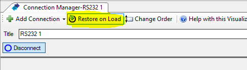

I know I can start MegunoLink using Windows 7 scheduler but can I also make the connection to my Arduino serial port automatic?
I'm no coder so keep it simple please
Fri Mar 01, 2019 6:17 am
Hi, create your megunolink interface and make sure that you have "Restore on load" selected (see below). Save your megunolink interface (.mlpz or mlx file). Now set up scheduler to launch that project file which should open up and automatically establish the serial connection if it is available.
