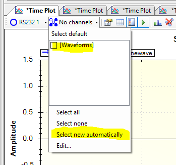

Seems to work fine for me. Maybe you have accidentally selected no channels.
Make sure either of the highlighted bits in the picture are highlighted otherwise I dont think it will work.
