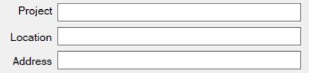

For example, I have multiple Textboxs eg Project, Location, Address, etc
I will describe the issue for a single Textbox "Project", where a user could type "XYZ drilling project".
The text is obtained via a command initiated from a Button
The command is as follows !SaveProjectData [IPT_Project.Text]\r\n
