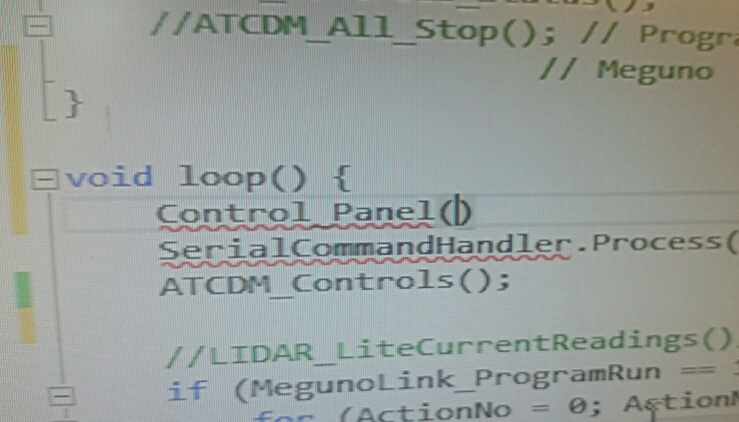

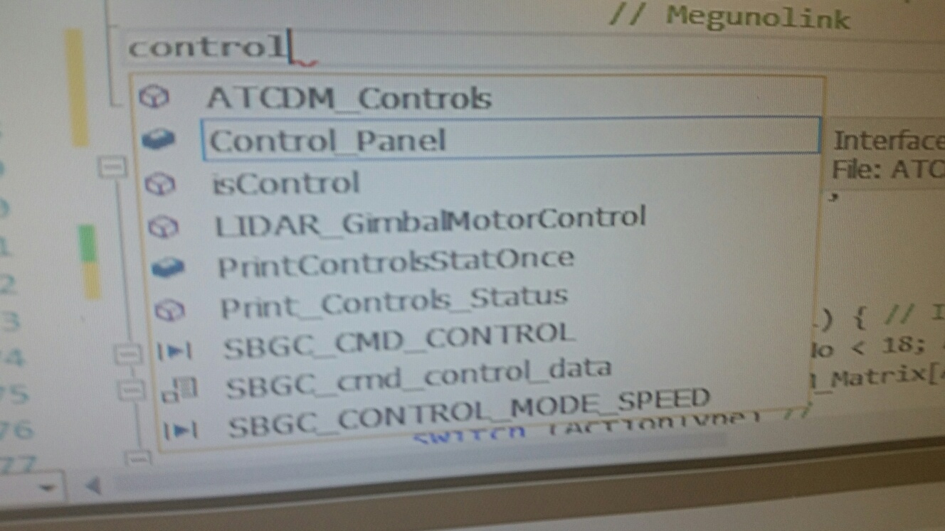

After declaring the InterfacePanel Control_Panel
I can use Control_Panel again in the Setup as noted here
But VS will not allow me to put Control_Panel in the loop as shown here:

Hi Bill, could you please send me a copy of the code to
support@megunolink.com? I'll check it out and see if I can get it working here.
What build tool are you using? Visual Micro or the MegunoLink one?
