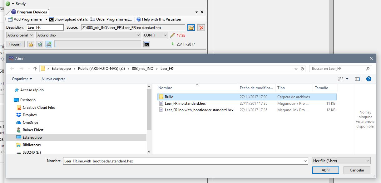

I was wondering how to programm my Arduino using the programmer. FIrst I tried to program it using the original *.ino file but no success.
The I read somewhere that I need a hex file, made a search how to make a hex file of my *.ino sketch and now after learning how to do that I have 2 hex files in my folder.
Which one is the correct one in order to programm my ArduinoUNO with MegunoLink ?
....ino.standar.hex
or
....ino.with_bootloader.standard.hex

I tried it here and both seemed to work fine.

Thanks. I was just afraid that the bootloader could damage the main programming of the chip or something :-)
