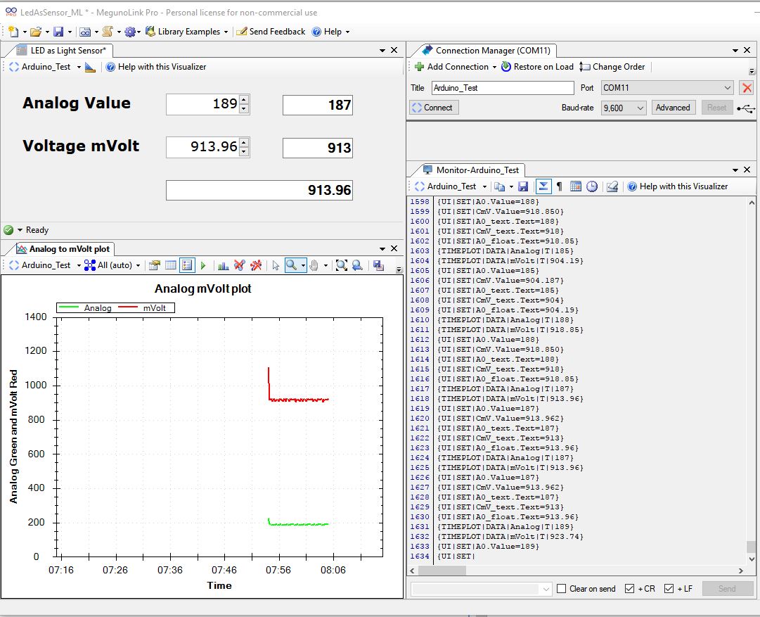

A few minutes later I tested it now with " .... float Value ) "
#include "MegunoLink.h"
InterfacePanel LAS;
TimePlot AnalogTomVolt;
int LedSensor;
float mVolt;
int mVoltText;
void setup()
  Serial.begin(9600);
  pinMode(13, OUTPUT);
  digitalWrite(13, LOW);
  LedSensor = analogRead(A0);
  mVolt = LedSensor * 4.8875;
  mVoltText = abs(LedSensor * 4.8875);
  AnalogTomVolt.SendData("Analog", LedSensor);
  AnalogTomVolt.SendData("mVolt", mVolt);
  LAS.SetNumber("A0", LedSensor);
  LAS.SetNumber("CmV", mVolt);
  LAS.SetText("A0_text", LedSensor);
  LAS.SetText("CmV_text", mVoltText);
  LAS.SetText("A0_float", mVolt);
  delay(100);
Here a screen shot with 2 numericUpDown boxes and 3 textboxes
