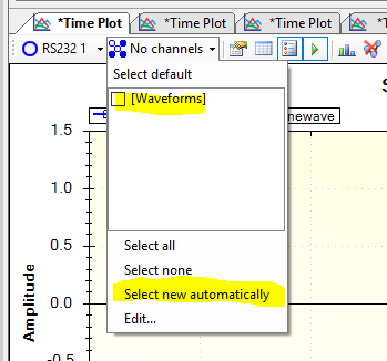

Seems to work fine for me. Maybe you have accidentally selected no channels.
Make sure either of the highlighted bits in the picture are highlighted otherwise I dont think it will work.

I see this problem as well. The advice about selecting highlighted values doesn't seem to do anything.
Not sure if this is related but when I attempt to look at Series Properties, it asks me to select a series. Not sure what it expects me to do. The graph is showing up ok, it just ignores any values I set for shape and color in the arduino code if they aren't the default.
