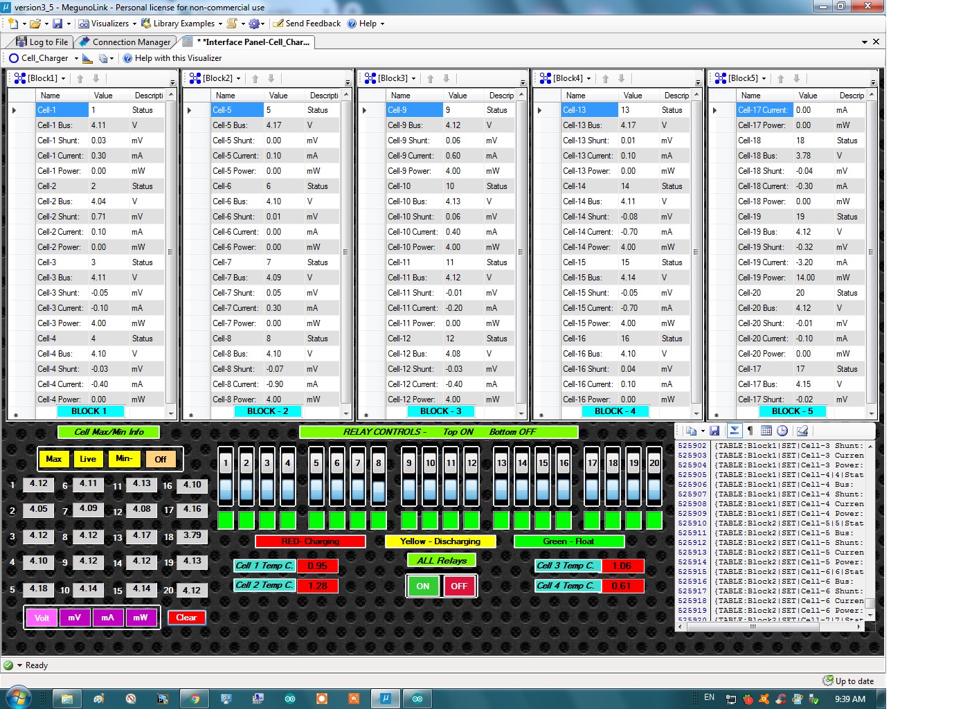

Here is what it looks like when you fine tune your project, each item you see is its own box. I havent counted how many i have used :D
Mike

Posted: Sat Jun 01, 2019 1:51 am
Mike that interface is amazing! How did you do the cool relay buttons?
Re: Interface object positioning
Posted: Sat Jun 01, 2019 7:46 am
by Mike-AU
The relay buttons were the easiest to do, they are just a pair of radio buttons, One sends a !RON 5\R the other a !ROFF 5\r command to turn pin x on or off on the arduino. The all on all off buttons just run a loop to set the 20 pins either high or low depending on the request.
