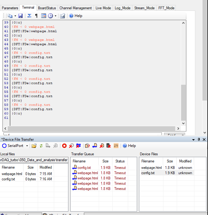

I now have this working to some extent but having problems with actual file transfer.
So it is working for "Request file list" but when I try to "Request file from device" it times out.
megunoLink_file_transfer_Screenshot 2023-11-30 071945.png (59.91 KiB) Viewed 310626 times
I have stopped all other comms from my device during this time but that has had no effect.
Any thoughts why requesting file list will work ie returns an accurate file list but not a file transfer?
I am using the sdFat implementation.
I have defined a buffer size of 200bytes at both ends.
I note that there is an option to enable diagnostics in the buffer size selection dialog. Is there a specific channel that needs to be defined for this to work?

Hi, I think there is a bug somewhere but I haven't been able to reproduce it. In the screen shot, the Arduino program is responding to the file request (that is the message
!FM < 0 config.txt
with:
{DFT|FDe|config.txt
|0|o}
This message is generated by FileSystemWrapper::SendFileContent because opening the file failed. That reply shouldn't have a line break though, which may mean it is trying to open the wrong file. That is, the filename it got has a newline on the end of it. The filename comes from FileManager::HandleGetFileContent. I'm not sure if MegunoLink is sending the wrong filename or the command handler isn't parsing the message it receives from MegunoLink properly (possibly retaining part or all of the new line).
Would you mind sharing a screenshot from the monitor with end-of-line markers visible please? Use Image in the monitor to turn on end-of-line markers. It would be helpful to see the messages from the file listing (!FM ?) and file request (!FM < Config.txt. Also, were the config.txt and webpage.html files already on the SD card, or were they uploaded by MegunoLink (if by MegunoLink, perhaps the file name problem occurs there).
It would be worth checking you have the latest version of MegunoLink, Arduino library too.

With some excellent debugging assistance from the MegunoLink team, I have been able to resolve this issue.
Turns out the problem was of my own making as I am using my own existing CLI to detect MegunoLink specific messages and them pass them on using the DispatchCommand function.
What I was not aware of is the requirement to strip the carriage return and line feed chars on the end of the message prior to sending these on. Once this was implemented all worked as intended.
