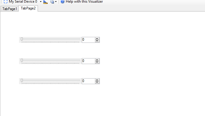

while working with the Interface Panel i have encountered a Problem, where the Indicators from the trackbars disappeared on all tab pages exept the last one canged. if I open the Panel designer again the "ShowNumericValue" option is set to false. If I then try to set it to true and then apply the indicators are still gone from the page and when I try to reopen the designer the option is set to false again. i cant have more then one tabpage with indicators.

The second page the indicators are still there and ShowNumericValue was left true.
On the second page the Indicators are still there
what can i do to have trackbars with Numeric idicators on all my tab-pages?

Hi Michael, that does sound like a bug. Will add to the list to fix for the next release.

Hi Michael,
This is fixed now with the latest update! MegunoLink should update automatically next time you start it, or you can download the latest version from: https://www.megunolink.com/download/
