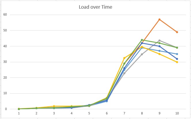

I'm new here, and a fairly novice Arduino programmer. However, using the guides, forums and help resources has gotten me pretty far over the past few days. However, I'm at the limit of my experience while trying to solve a problem. I have built a machine use to test part stress failures of 3D printed samples. I typically print 5 or 10 samples of each beam design, then load test them for their failure points. I've been able to successfully collect real time data using the TimePlot function, however I am trying to find a way to record data so that each collected sample, is drawn over top of the existing data. Ideally, each collected sample would be a different color.
Here is an example of what I'm trying to achieve.
Data Plot Example.jpg (30.97 KiB) Viewed 52533 times
is it possible to record data on the chart using the Fixed Time method, however at each sample, the time would revert to Zero and redraw then next sample data over the previous data sets.
Thank you in advance for your assistance. I'm looking forward to learning more.

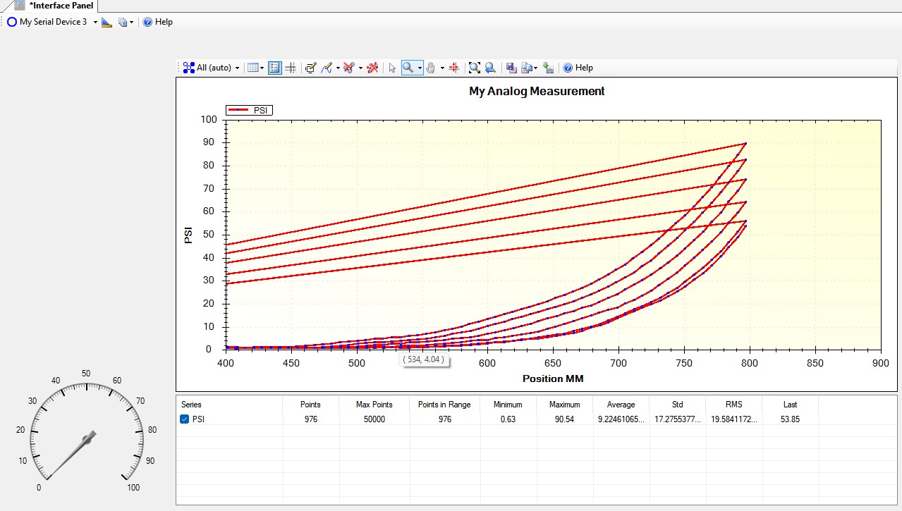

Thank you. I was playing around with XY Plot just now and decided to do a test with the X axis reading the number of steps counted from my stepper pulse routine. It sort of works. At least I understand how I could use Timebase to achieve a similar result.
XY Plot Example.jpg (176.22 KiB) Viewed 52526 times
It seems like I'll have to create some sort of "For" statement to count each cycle press and then use that counter to create a series name and possibly alter the individual plotted series colors.
Any idea how I can eliminate that long diagonal line within the plot as it jumps from the high point back to the "Zero" point?

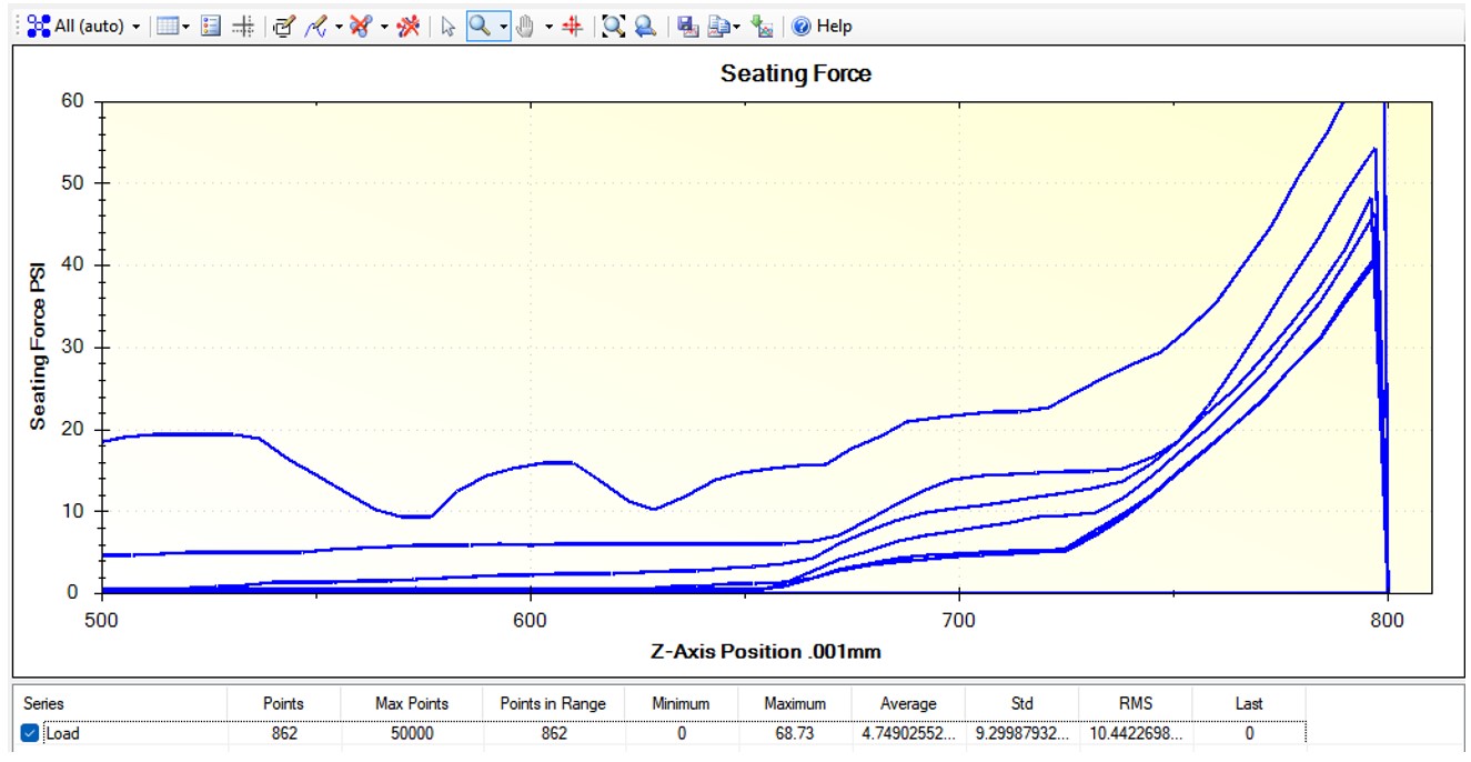

Well, I'm making steady progress. I've been able to plot multiple readings onto one chart.
Multi Series Plot.jpg (141.03 KiB) Viewed 52518 times
However, I'm hitting a brick wall with respect to finding a way to create some sort of method to create some sort of incremental series name, and change the plotted line color, during my program loop.
I thought I could create a simple array to input the color variable and increment the series name as just as a simple integer.
int plColor[7]={"Red","Green","Blue","Yellow","Black","Magenta","Cyan"}
for(int s=0; s<7; s++)
plColor[s]
psiPlot.SendData(S, plColor, x/64, pressureValue);
I appreciate any suggestions or hints to point me in the right direction to achieve this chart format output.

I wanted to circle back and say thanks. It took me a week to teach myself what I needed to do, but Pstring worked perfectly.
Series Data.jpg (145.41 KiB) Viewed 52469 times
I figured I would share the function here for others to learn from.
// Pressure value function
void pressureData()
{ char buffer[10];
PString series(buffer, sizeof(buffer));
series.print("Test-");
series.print(cycleCount);
currentMillis = millis();
{ pressVal = analogRead(pressureInput);
pressVal = ((pressVal - pressZero) * transMax) / (pressMax - pressZero);
XYPlot psiPlot;
psiPlot.SendData(buffer, plotX/32, pressVal)
MyPanel.SetNumber(F("Seating Force"),pressVal)
startMillis = currentMillis; //IMPORTANT to save the start time of the current state.
