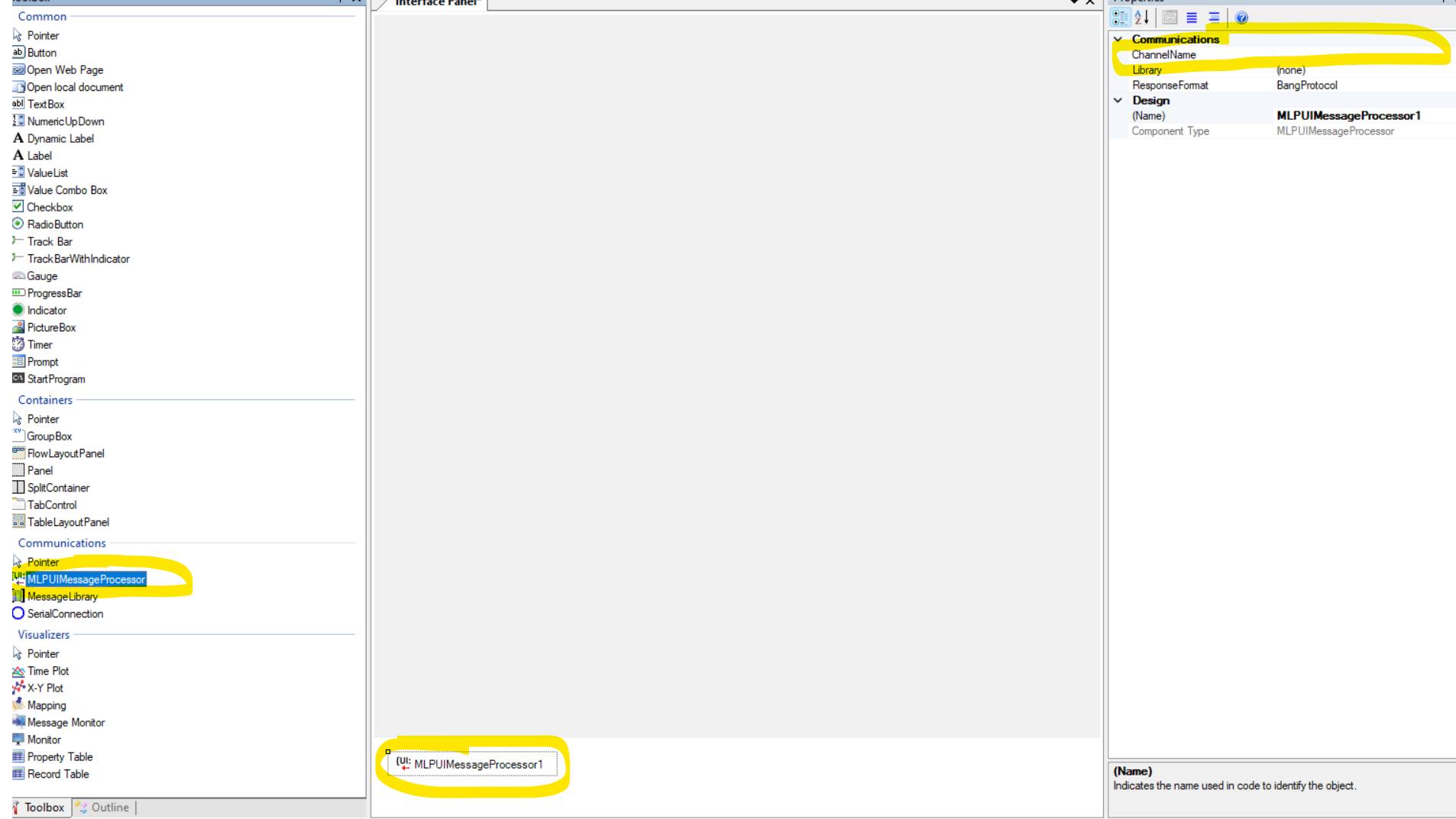

Hi try adding a MLPUIMessageProcessor to each interface and naming the channel as you describe. See image below
Screenshot 2023-05-11 195709.png (211.2 KiB) Viewed 217266 times
