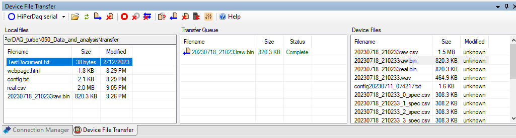

During my work to implement and debug the file transfer mechanism in my project, I figured out a method to support long filenames from the microcontroller side.
In the function GetFileName within SDFatFileManager.h, I changed the definition of a local char array to be larger:
   virtual const char* GetFilename(SdfmFile hFile) override
      //static char achFilenameBuffer[13];
      static char achFilenameBuffer[m_maxFilenameLength];   // edited CDS 14-12-23
      hFile.getName(achFilenameBuffer, sizeof(achFilenameBuffer));
      return achFilenameBuffer;
Where m_maxFilenameLength is defined in the header file as:
 static const int m_maxFilenameLength = 100;
Note that this only enables long filenames from the microcontroller side to the PC, but it does work nicely.
