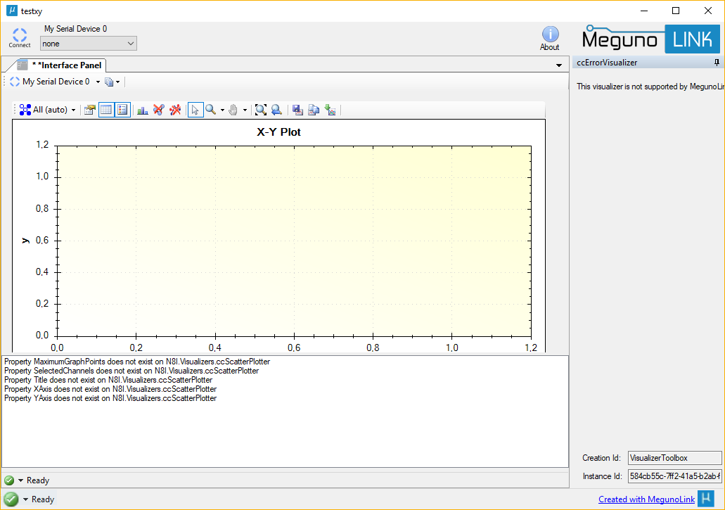

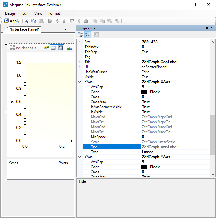

When i run an interface from an installed package that i made using the builder, errors appear. I can just ignore them an make the window in which they appear smaller . The interface is working as expected but i would like to get rid of the white messagewindow. See attached second image below. I can set the axis labels using commands from the arduino. I cant set default values using the properties window in the designer app. The values are grayed out. See window below.

Hi, I believe you have left your visualiser selection window open in the original Megunolink interface. This isn't supported in builder so needs to be closed before saving your mlpz file and creating your installer.
