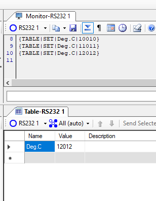

Hi Alain, I tried to reply to your email but it says its getting rejected. Anyway ill copy the reply here.
I tried your first example and it worked fine. I did this:
Serial.println("{TABLE|SET|Deg.C|"+String(millis())+"}");
Which printed the millis timer to the table. Seemed to work.
As for your second question in the email you had only DATA not SPEAK+DATA
I tried this and it worked fine on my computer.
mySerial.println("{MESSAGE|SPEAK+DATA|Parameters:"+ myParams + "}");
In short we haven't changed anything that should have broken that functionality. Confirm in your serial monitor you are getting the messages correctly. Raw messages should look like this

Thanks Phil, just to make sure: In order to have the {MESSAGE|SPEAK+DATA... working I need a message monitor ,even that there is no printed data on it, just spoken data?
Re: Support to speak message?
Posted: Sun Sep 22, 2019 6:16 pm
Yes that is correct. That establishes a listener for that type of message. Without it they don't get processed by anything.
