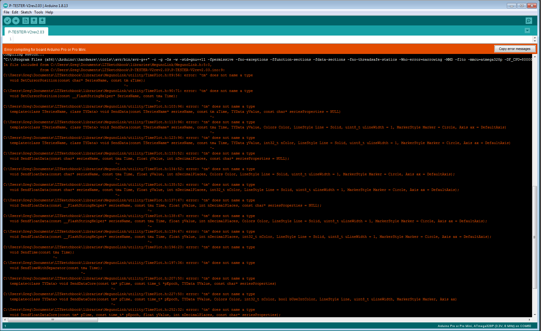

Hi, earlier this year i built a project using my arduino, pressure sensor and the megunolink to measure and monitor a pressurized tank and it worked great. Recently i built another pressure tester and i tried to compile the exact same code into the sensor and it errors from the megunolink library. Has something changed in the driver that would cause a sketch from say march to not compile?

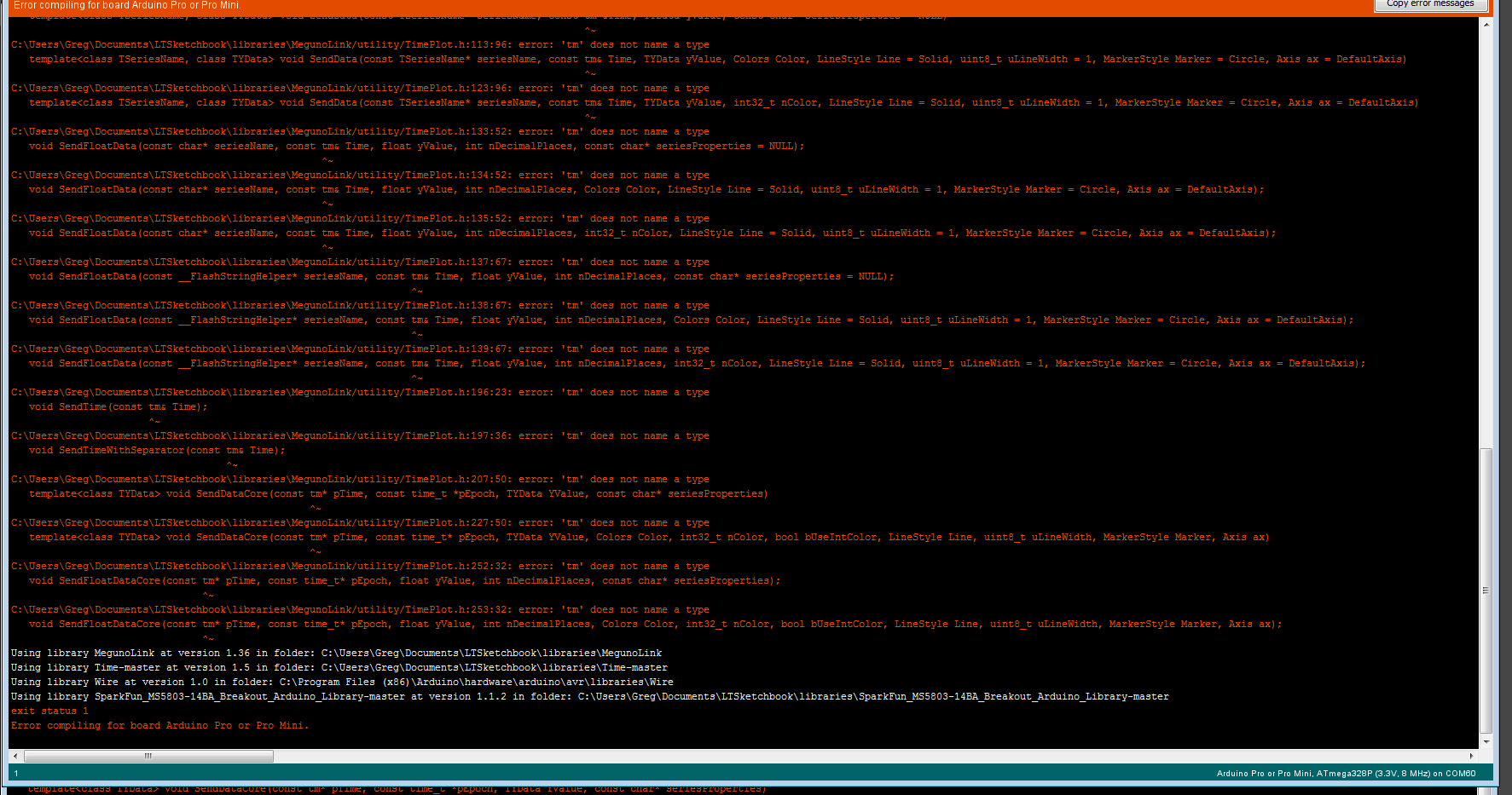

this sketch always compiled without issue, now it errors.

Hi Goho,
I noticed you also have a library called "Time-master" in the build output. My guess is that there is a conflict with that library and the built-in "time.h" library we are using. That could happen if the "Time-master" library has a file named "time.h" too (it could override the system one).
To resolve, you could rename time.h in the time-master library to something else, propagating that change to any #includes in other files in the time-master library. I found a few Arduino time libraries so I'm not sure which one you are using. If you could post a link to it we might be able to figure out a different solution.
It looks like support for sending time values with our plotting library was made in January this year. So likely is the problem.
Have a good day
Paul.

i updated the Time library and it compiles ok. Problem solved!
