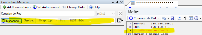

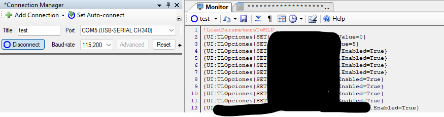

everything works great when I Update Interface Panel From serial port, but when I change to use ESP32 TCP Command Handler nothing happens.
esp32 receive data, but is not sending nothing back to megunolink interface.
send_serial to meguno.png (41.61 KiB) Viewed 276283 times
thanks
NOTE: ESP32 is receiving all data sent from interface panel, the issue is sending data back from esp32 to megunolink
any advise?

Are you confident the TCP command handler is calling your handler function?
Have you tried monitoring the traffic with a tool like Wireshark?
Wed Oct 30, 2024 7:02 am
Im not 100% sure but there could also be a limit on command length too. Maybe try a shorter command.
