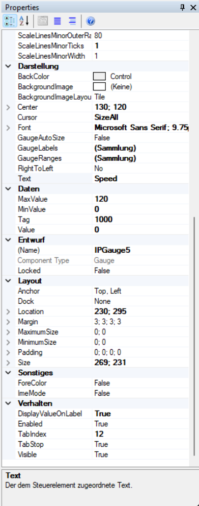

I want to display a value at a gauge but it doesn't work and I can't figure out what the problem is.
Ist there anybody who can help me please? Wouldbe realy nice.
Here ist the code block from my arduino UNO R4 minima:
    Serial.print("{Gau:IPGauge5|");
    Serial.print(linearSpeedKmh);
    Serial.println("}");
The propertiers of the gauge look like the pic in the attachment.

Assuming your gauge control in the interface is named IPGauge5, you should send something like this from your Arduino:
Serial.print("{UI|SET|IPGauge5.Value=");
A few important notes:
Use UI as the prefix
Use the SET command
Use the .Value property (or whichever property your gauge uses — check in the Interface Designer)
Make sure the entire command is wrapped in {} braces
If you have multiple interface panels or want to target a specific channel, you can also use this format:
{UI:ChannelName|SET|IPGauge5.Value=123}
This ensures MegunoLink correctly parses and applies the value to your gauge.
