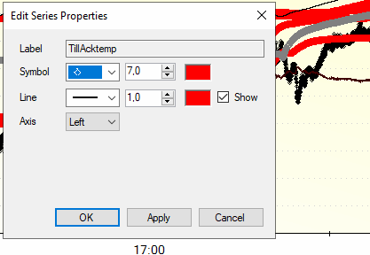

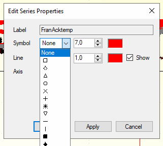

I can not change the series property. when changing it goes back after a short while. Why?
It always goes back to line with symbol.

Hi Pelle, its probably because you are setting the line properties from the arduino end as well? This will overwrite the local changes.

No I am not setting any properties.
MyPlot1.SendData(F("UppAcktemp"), UAckT,"Grader");
MyPlot1.SendData(F("MidAcktemp"), MAckT,"Grader");
Is there any wrong with above?
Should i set properties maybe?
Mon Jan 27, 2020 2:32 am
Are you clearing the plots? That would reset them to the defaults when the next data comes in. Maybe setting the properties in the plot message solves your problem?
